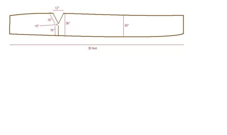

BTDT.
1. Get an old chain that you aren't afraid to send into the dirt.
2. Disclaimer that this requires cutting straight down through a log, that means that you are gonna need to be careful how you approach the log, because if you don't use the right technique you are gonna hit the log with the tip of your saw as you begin the cut. refer to the picture below for how to START the cut safely.
3. first step is to break the log into smaller manageable pieces. this could be 3 10ft pieces, or it may be 5 or 6 pieces. when possible, cut through points that are less than 32" so it doesn't waste wood.
4. refer to picture to see that you can use a smaller bar to get through a large log. pythagorean theorum you can determine that making a wedge shaped cut will give you two 16" sides and a 12" side (or whatever you need to be able to fit your saw in further) this makes a cut that is only 14.8" deep, but allows you to then get your saw into the cut to get the remaining few inches you need. it may be necessary to take a wedge from both sides or only one.

A few thoughts: a 30' log 30" wide is not going to roll very easily.
whereever it is currently off the ground you should jam some splits or branches under there to keep the log from falling into the dirt.
start at the small end.
when you get to the point where you can't reach the middle from either side i would suggest finishing it with a hand saw or removing a couple of splits to gain access with your chainsaw.
bring a big truck because that is going to be a lot of wood!
I really like Danno's idea too... especially if the log is too large/odd shaped to roll.

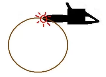

Why would that be a problem with the way you are cutting in the diagram? The danger zone for kickback is at the top corner of the bar tip, isn't it? Looks like the bar would only touch on the bottom corner of the bar in your drawing.
Battenkiller said:
for a split second your bar will only be touching on the bottom, but as soon as your tip is an inch or two deep, then you have only a few inches of the bottom of the bar and the tip is at risk of really catching.
I, personally, only make sure I am a little more aware of my stance and potential danger zone if a kickback would occur, and make sure I'm running wide open and then cut away. It's important to know risky cuts just so you can be extra cautious, not to scare you completely away from doing them.

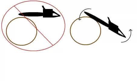

maybe this picture gets the idea across a little better.

As others said, start a the small end of the log and work your way down. When the logs get big, do as smokinjay says. When they get bigger, you can do as Danno says. Just be careful to start your bore cut with the lower quadrant of your bar. Start to cut like you would normally, then pull the tip of the saw to the middle of the log and rotate the handle of the saw up while applying modest pressure at the tip. While you are rotating the saw up, the tip should be starting to bore into the wood. Once the tip is in, you can rotate the saw to 90º and push straight in with no fear of kickback. You can also noodle the logs to take chunks off the sides.
I see what you are saying now, but I would never think of starting a cut that way. Good to point out to folks who might, however.
