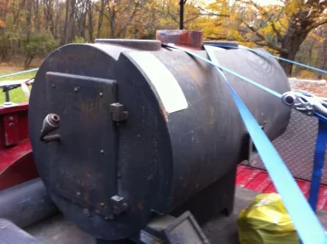

    i just picked up an old fire view like yours a few weeks ago. i will be hooking it up in pole barn. i expect it to pump out a lot of heat. how is yours?

    No a Fire View,see my signature EDIT found a pic of an Orley, it is similar
    I was wondering if anyone on here had ,or has one.
    This stove will put out more than enough heat for my house on the coldest days, I can put a 3 foot log in this puppy.
    There is another stove I have seen on here called a Fire View, that;s nothing like mine.
    If U looked at my sig yours is like mine

    i need to order a boot to go through the steel roof

    Where can you get that kind of boot ?

    Pipebootexpress.com
