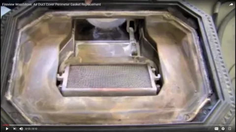

Thanks Webby3650. Do you think there’s an issue with the whole area around the cat (I think it’s called the bypass cover and door)? Looks warped to me in this photo:
[Hearth.com] How's this used Woodstock Fireview Look?
As opposed to what I think one is supposed to look like in this photo (not from this stove):
If this is warped I believe I can fairly easily swap it out, but how much might this be a sign of deeper underlying problems?
I’d hope it’s an optical illusion. It would be hard to warp all that iron. Guess it’s possible?
Yes, the shadows are deceptive. Need a better shot with flatter lighting.

Yes, it's hard to say for sure from just pictures but it appears to me that the bypass frame and door may be warped. The cat frame is warped, but that happens fairly easily, and the steel cats they sell now don't even use that cast cat frame.
I could be wrong but it looks like the stove has been burned hot many times. For it to be right, it probably needs to be completely torn down and rebuilt, replacing warped parts, re-cementing all the seams etc. I'd avoid it unless you want a project. If you like the style and the stove is the output you need, you could ask Woodstock what they would charge to rebuild it. Then again, in your neck of the woods used Woodstocks can probably be found with some regularity, and you might even score a great deal if you're in the right place at the right time.

If the owner was using the stove to heat a space about twice the size it was designed for there is a good chance the stove spent most of its life with the pedal to the metal. I would pass unless the damages are local, repairable and affordable.

I don’t know, I don’t typically see big pieces of iron like this one warped but not cracked. It’s still hard to tell. The cat housing doesn’t look warped to me, the bolts aren’t securing it so it’s sitting crooked.

It very well could be warped. It’s just so hard to tell. I can post a pic of mine as a comparison in the daylight.

For $350 it's probably worth it. You might have to replace the gaskets and the piece by the Cat but Woodstock could probably walk you through that process. It does look like it has been run hard, but, they are made to be run hard.

It's built with a series of bolt ins. It doesn't look like the cat combustor pan (W-160) is warped, but you could call Woodstock and ask what the cost is for replacing.

@KennyK, who did they suggest for ordering the ceramic cat? That cat frame doesn't look too badly warped. As long as the frame isn't warped longitudinally, I think the interam gasket (which expands and seals gaps when heated) should seal gaps up to about 1/8". Even if you have to buy a cast frame, they aren't too expensive. Or you can just go to the steel cat and you don't need the frame. I wouldn't shy away from a ceramic cat at all, though. I have the original ceramic that came with my Keystone as well as a steel cat, and I switch back and forth between the two, both work well.

The stove might have been run too hot bringing it up to cat light-off temp (bypass open.) That would warp the bypass frame since that's where the flames would be concentrated in that case. If the stove were run too hot with the bypass closed, the combustor pan (W-164) would probably be protected somewhat by the old cast iron combustor scoop, which I can't see from the angle of the firebox pic. The cast iron cat scoop was warped on the used Fireview my SIL bought, and I just replaced it with the new stainless scoop. The bypass frame and combustor pan weren't warped on hers. I had to re-cement some interior seams between soapstone pieces that were leaking air, and the furnace cement that Woodstock makes worked well for that..very stringy and tacky. Inside the box, you will see light-colored strips next to the seam if an air leak is occurring there; It will burn off the creosote. You can also tell by observing the burn; If conditions are right in the firebox, smoke will ignite near where air is coming in.
You may have to fix a few things but like toddnic said, hard to go wrong for $350. That combustor pan might be a bit more work to put in though, if you need it.
