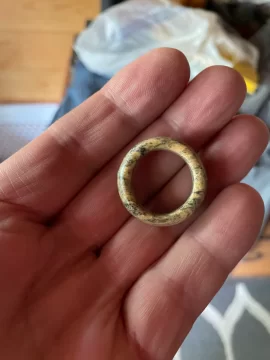

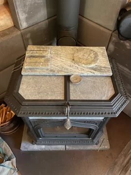

Have some leftover soapstone from the rebuild. Made some boot warmers, trivets and even a ring.

I have a bucket full of river stones that I use for that! I use them, or used them, to dry the boots. I picked up a boot dryer at a garage sale that may retire the rocks.

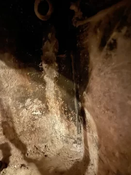

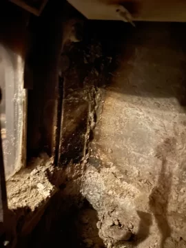

So the last couple days I noticed I had to shut down the air all the way down to #0 to get a long burn with slow lazy flame. Usually a little below #1 will pretty much snuff out the flames or give me that rolling ghost flame above the logs. Also had some jet like flames in the front left corner so I let the stove burn out today because I know what the culprit is and sure enough I’m missing cement in some of the corner seams.
Anyone who rebuilds one of these stove I recommend go generously with the stove cement. Smacking the corners with a log can dislodge or crack the cement causing the stove to suck in more air. There is no cement on the outside stones so that inside layer needs to be tight.
I’ll try and fill these gaps best I can for this season then I’ll remove the air duct for better access next summer and get it done right.
