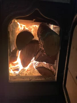

She’s broke in and loaded her up with a pretty full load for the overnight. Seems to be burning pretty well.

Looks good........So it's side load only?
Yes, I believe all Woodstocks are side loading except the Ideal Steel and their little Survival stove.
Reactions: bigealta
So it looks like the cat is glowing and active. How are cat temps looking? 16 years since you ran a Fireview?
More like 20 years I think. I don’t have a cat probe just running off the flue temp. Once I hit 500 on the flue I engage the cat around the #1 air setting and adjust from there. I don’t think this old cat is a 100% because it’s taking a little longer for stove top temps to come up compared to what I remember but there is no smoke out the chimney. I have a new one on order then I’ll keep this old one for a spare.
