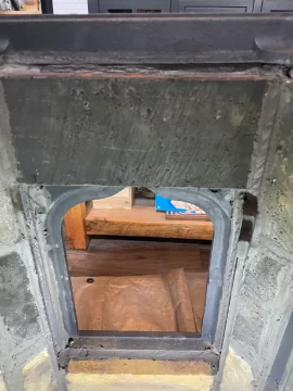

Hi Todd and everyone. I just picked up a Fireview 205 for 600.00 in my neck of the woods, just like yours. What a great forum. I’ve had wood stoves in past but not for last 6 years and never really gave them much thought. We moved to Tucson last year and really don’t need heat except a little bit at night and in morning for a few months in the winter so I thought perfect to get a little wood stove and cut the gas off to the Gas Pak unit on the roof so it is just an AC unit now.
Mine was made in 2007. I’m so glad to see your post. I should have talked him down to 400 after getting it home and seeing what you had to do. I was thinking i was just going have to clean it up a little and paint the mask and then paint metal.
I’m thinking taking apart like you may be the way to go. Any regrets there? Is there a document besides the parts list you are following to take it part from Woodstock?
I started with the feet and 3 of 4 came off, one threaded rod snapped, and one is just spinning.

Hi Biopete,
Yours looks to be in a little better shape than mine. Most of my outside stones were disintegrating or chipping. You’ll get a better idea of what you need once you remove the baffle. That’s the easy part. Check all the internal cast parts for warping or cracks and check the condition of the inside stones. You may get lucky and only need to clean and painter her up along with some replacement gaskets.
Before you take those tie rods out wrap a rope around the stove to keep it together. Take the baffle out first then tackle those tie rods. I used a small vise grip to hold the top of the rod and then loosened the bottom nuts. Make sure the rope is tight around the stove then work that top cast frame off, it may take a little persuading with a rubber mallet. When mine popped off all the outside stones tried to fall away, lucky I had the rope around them.
I’ve been waiting for over three weeks to get parts from Woodstock so it’s probably good your in no rush. It’ll be less busy in a few months.
If you need any help let me know.

I wouldn’t take it all apart if you don’t have to. Just inspect the baffle, scoop and bypass for warping then replace those as nesessary. Order the gasket replacement kit, new cat, and paint. Also inspect the cement inside the firebox between the stones.

Started putting her together again. It was a pain figuring a way to keep those corners from falling in or out, had to get creative.

Did the cementing today and bolted it all down with the four corner tie rods. The top frame gave me some problems lining up then I heard a scary pop and she settled into place.
Probably install the guts tomorrow then give it a couple days for the cement to cure then install it.

She’s done! It went together pretty well, just had a few issues with a couple spacers that help line up the combustor pan and also adjusting the bypass. I need to let her sit for a couple days to cure the stove cement then I’ll look into installing.
