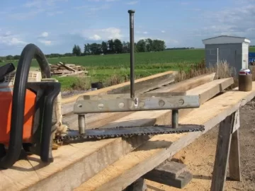

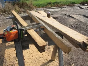

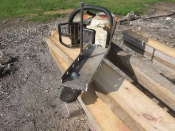

to turn some cedar barn beams into 2 by boards. Not willing to cough up the dough for a fancy grandburg mill I went to the scrap pile and plumbing parts box and in about 10 minutes I was in buzness. So far it is working better than I had hoped.

Can you give us a few details. Does the saw move down the guide board, or does the board your cutting move? Is the long vertical bolt a handle? Are you using a standard chain? Reason I ask, I thought there was a chain for rip cutting. any idea what that chain is?
Excellent design work!!
I'm cutting square beams down so no guide board needed. Just push the saw thru the wood. The long bolt is actually a 12 inch land scape spike that is welded to the channel iron for a handle. I wasn't sure how this set up would work so for now the chain is just my normal semi chisel chains and the bar is a badly wore out bar that I just couldn't throw away. To cut different thickness' I can change out the bolts and pipe nipples that attach it to the bar.
