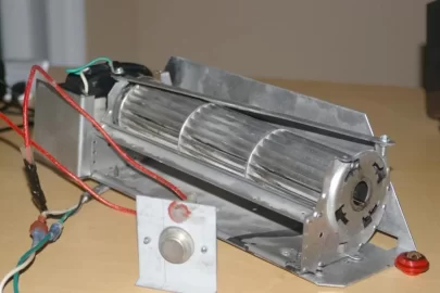

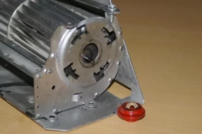

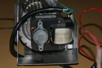

Here are some pictures of the unit. The bushing can be seen in the red cap on picture 3715
If you can't repair the bushing look here you may be able to get something close..
(broken link removed),
Ray
The pictures are good. Looking up a unit or two now. Can you take one more shot that shows the motor label clearer? And if you can post the blower dimensions that would be great.
northof54th said:
BeGreen,
There is not any manufacture name on it, at the price quoted for this little thing, I am sure it must have been made by god himself.
