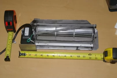

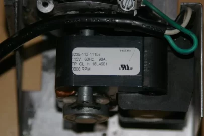

I need a new fan
Here are the requested additional pictures. Thanks to all for your input.
Don

It looks like the blower wheel width is about 9+ inches. If so, see how the specs for this one compare:
(broken link removed)
or this one (there has to be something wrong with the price listed for this one. It appears to be on clearance, while supplies last.)

I think that blower is made by Fasco.
I've never bought from them, but Electric Motor Warehouse has what they claim to be replacement blowers(middle of page) for the UZY3 for much cheaper...also a UZY4 closer to the bottom.
http://www.electricmotorwarehouse.com/fireplace.htm
That doesn't look like the one in the picture. Are you sure its original?
My BIS has a UZY6 and it looks about the same as your pictures.

I have tried to oil the bushings with some 30 weight oil and some synthetic that I had here. Same result each time, quite at first but after a hour or so they begin to rattle and slow down. Last night it even came to a stop. Will move today, but I think I need to consider getting a new blower.
The one in the picture may not be the original UYZ3 as the fan that the dealer supplied with the unit crapped out 2 years ago. At the time I attributed it to the fact that I was running the fan with a dimmer/ fan control. But it failed in the same way as the current one - got noisy and quit working. So not sure if the old control had anything to do with the failure of the old unit. Maybe these things just fail after 2 years of high usage. We use our BIS allot!
thanks for the link, I will be checking it out this week (along with some others) so that I can get back to my happy place (on the sofa in front of the BIS).
Did you try drilling an oil hole over the shaft bearing block? That is where the oil must get if it's to be effective. It could be that the motor is too far gone, but if it's going to tossed there's nothing to lose by trying.
