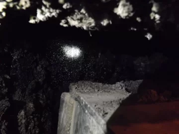

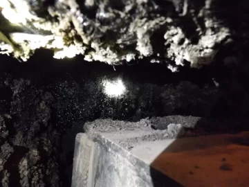

Threw the towel in on an old cat insert, good thing as it turns out it was a slammer anyway (phew!) _g too close for comfort for a chimney fire, I will spare you the details. |The double wall pipe atop the chimney fooled both us and the company that cleaned it last year...

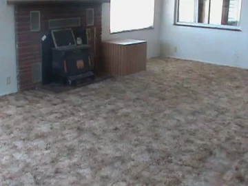

So did you get the Englander? If not, might as well if the price is good. Unless, this is not really a masonry fireplace. Normally they don't have a metal chimney. Post a picture or two of the fireplace and the chimney.

I am not buying anything til I find one with approval here on a good (ecomical) stove here :):) I am not concerned with aesthetics but the hubby prefers an insert.
House is ~1950's, concrete block walls and chimney (~15' + high). We bought the house last year, and had the chimney "swept" but it looks like the all the sweepings just laid ontop of the insert. How are you so patient with new burners?!?! Sure enough it looks like metal behind the old insert. _g

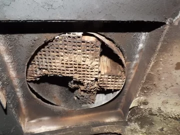

Hubby took faceplate off but I cannot move the stove, did the best I could to get a discernable pic,...

Now that's a slammer but that's not a insert. at least it don't look like it with my old man eys..lol..it is a Blaze King though. I Think..lol.
Maybe I'm all wrong..let some younger eyes look at.

Blaze King! Rectangle flue with NO adapter (shiny creosote everywhere as far as I can see so far). No liner that we can find so far, waiting for a camera drop down the chimney.

Sure cooked that cat!
