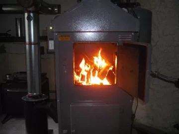

I see that you don't have the smoke flap installed. You must get quite a cloud of smoke out every time you open the door?
yeah can be pretty intense. It is in the garage so its not a big deal but the ceiling is all ready dark brown. I plan on getting the smoke hood real soon.
The smoke hood, with no smoke flap in the way, is an outstanding improvement!

That flap looks like a real pain.
Combustion control of a batch burn of mixed mc and species firewood , regardless of control strategy is difficult to nail down. one parameter differs slightly and the whole burn changes signifigantly. the parameter changes available on each boiler obviously determine the success of its combustion control capabilities. Sometimes our expectations gained through shared knowledge are beyond the manufactured design capabilities. With what each of us has to work with, p/air, p/s air, static or variable speed air or any combination of will determine our degree of ''success''. For some it is just having enough hot water, for others it is the process value and setpoint line being one and the same, for me the latter. From a process control standpoint , consistency in a batch burn within your boilers capabilities is more realistic than expecting perfect burns . Most sucessful boimass boilers are controlled with a combination of independant p/s air, variable speed inducer determined by a firebox pressure, o2 feedback and a complex control algorithim, and probably autofeed. There is alot to learn from and tinker with, and this is half the fun.
I found before I had my hood vented that the flap did a lot to keep the smoke in. I learned this from watching the clouds billow out whenever I raised it to load the thing. I'm also learning that because my wood is not fully seasoned, I need to keep a good load of coals going and load a couple of logs every couple of hours. That way the fresh ones at the top of the pile dry out. Once it goes down to 150 or so, it seems to take forever to get it back up. Have a Merry Christmas, or Happy Chanukah, or whatever celebration you engage in.
