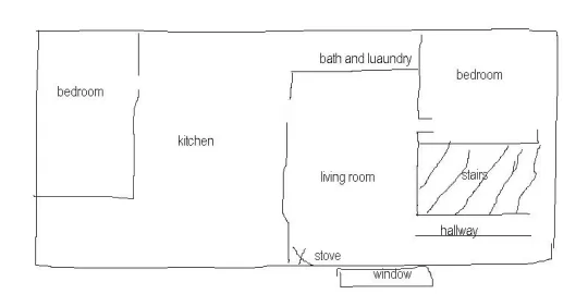

I've attempted to draw the floor plan we live in. Very crude. The total bottom floor space is about 1700 square'. The living room is 190sq.'. Heat flows into the small hallway using forced hot air. The only place we can place the stove is in the corner. I'm thinking a medium stove. If the living room gets hot but tolerable, allright. Your input will help us to decide on size of stove and whether we go 24/7. I'm new here and have read much on this site. The house is old but with improvements such as window weatherization and such it is holding the heat in pretty well. There are two small bedrooms at the top of the stairs with one having a vent into the living room. The entrance between the living room and kitchen has an airway at top for airflow. Also, there is a wall vent for air between living room and bathroom/laundry room. The house rests on a full unfinished basement with oi forced hot air furnace. The stove pipe would go through the 8 ft. ceiling, into a 4.5 ft. crawl space and through the roof. Pretty average petched roof, but pipe will need to go up a bit since it will be on the lower part of the roof. thank you so much for helping!! This is our first stove.

No offense Furstfamily, but that floor plan is awful. A bedroom off of the kitchen? The bah and laundry on one side of the living room? Where is the entrance/exit to the outside? Do you have shed roof or is every wall in there a retaining wall? I'd consider some serious remodel.
As for maintaing the current floor plan and adding the stove, I'd move your "x" up to the edge of the entrance to the kitchen.

I'm sorry. My floor plan sucks. The bedroom off the kitchen was a dining room. We have a large family so now it's a bedroom. There is an outside entrance at each end of the house. The house is old. They call it a New Englander style home-- whatever that is. We are new home owners also. These things take time. And I am new, very new to it all!! I'll study some more and come up with a stove plan. Thankyou for your input though.
Heating the living room will be easy, getting the heat around the house will be a bit more of a challenge, but not impossible. Is there a doorway going to the hallway and stairs or is it flat ceiling from the livingroom through the hallway? If flat ceiling, some of the heat will naturally follow along to the upstairs.

There is a doorway leading into the hall. I turned the furnace heat up to 70 and ran a fan from the hallway into the living room and lots of air streamed in. Without the fan air still circulates. The entrance to the kitchen is uninterrupted. My main concern is stove size. Warm air does go up through the vent in the living room to the bedroom upstairs, but we keep the heat on 60. You can feel the heat coming up when the heat is higher. So, I can manage air flow. Don't want to be blasted out of the living room.

hey im no expert but i would agree with moving it up to by the kitchen just so more heat would get in kitchen i like bedrooms colder and find with my stove i have to close bedroom door. that floor plane isnt so bad man 5 kids im impressed u have any room at all.
Is that wall between the kitchen and livingroom load bearing? If not, I would knock it out to give you a more open floor plan.

Yes, the wall is load bearing. If the stove is in the corner it still is only about 7 feet from the entrance way into the kitchen. We are used to 60 degrees in the house so 65 degrees in the kitchen would be like beach weather. We're not greedy. No problem with carrying wood and stuff. I want a wood stove. Please tell me we can have a wood stove. How much fun can it be! Thank-you so much for your help.
one thing i noticed , well actually a few but , to our poster; i want you to look closely at where the stove will be and the chimney , look at it in relation to the higher roof, you must take that into consideration. a chimney built through a lower roof adjacent to a higher one is a tricky thing. not a thing that cannot be done , but the standard rules do not always apply. can you supply us a drawing or digital picture of the house , looking at it from the side the stove would be closest to and mark on the picture ,. or describe where the flue would come through the roof? from what i gather you are looking to do this on a kinda tight budget (thats ok) i work with folks all the time who do. but im looking at the higher roof as being a bit of a problem if we do not plan for it.

Go for it, your main concern now should be getting a safe, quality installation. There are pluses and minuses to most stove locations. I think it will be ok where you've chosen to install it. The large opening to the kitchen will help to get some heat in there. If your ceiling in the living room is high enough to handle a ceiling fan, then that will assist circulation. If you can move the stove out of the corner it might be better, but it's not that it won't work there. The current corner location will help get some heat upstairs as well. Particularly if a small corner fan is blowing toward the stove.
