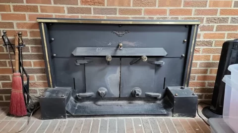

I need help identifying this wood burning insert .
Please see attached picture. I can find no markings or name anywhere.

It's probably just a locally made insert from the 70s or early 80s. Is there a liner hooked to it running out the top of the chimney?
Yes and the boxes on sides have fans inside
Yeah I knew those were fans. It's a pretty common setup for that time. What are you looking to find out about it
parts or manual.
Or, maybe instructions how to use it or a similar model.
You aren't going to find parts. Other than firebrick. You can probably find fans that will work by cross-referenceing the model number on the motor itself

Are you sure there is a stainless liner hooked to the stove and running to the top of the chimney? When stoves like this we're installed it was common practice to just slide the stove into the fireplace with no connection. We quickly found that installs like that were not safe and they are no longer legal.
Not sure about the liner. It was built from the ground up, and not just slid in an existing fireplace. I am pretty confident that it has a liner, but am trying to find out now. I know the son of the man who installed it and am looking him up as well as calling for an inspection.
I have found it is a Dare IV mfg by Harrington mfg. It has name and date in raised lettering on back of one door.
No liner, just exhausting in chimney. Has been used like this for over 40 years. House and chimney still standing. Anyone have any experience with putting a flexable stainless steel liner down from the top of the chimney? We can fabricate an adapter for the top of the insert to fit the stainless steel pipe. Any advice appreciated.

Yes I have lots of experience putting liners in. About 80 a year. What do you need to know? What size clay liner is in the chimney? What size is the stove outlet?
No clay liner, just brick. We will have to fabricate a pipe adapter. Is 6-inch flexible stainless pipe big enough?
If not, there may be room for 8 inch inside chimney.
I have been down this road in the past and wouldn't recommend it. The amount of money spent to buy the 8" liner plus the rectangle to round boot adapter and the time to drill and tap the screw holes just doesn't make it worth it.
But its your money, here is how to install the boot: https://www.rockfordchimneysupply.c...rectangle-to-round-stove-insert-adapter-boot/
If you go with a newer stove you can use 6" liner and save some money on that and burn cleaner.

Chances are you will need an 8" liner for that stove. But you can determine that by measuring the outlet on the stove and matching it's volume. An off the shelf boot may work but we usually fabricate them out of stainless.
You will also need room for insulation on the liner as well

So, is it a violation of some codes to adapt an insulated stainless liner to this insert and use it?
It was built in 1980 and does not meet current standards.
Is it a violation to use it as it is? It was used over 40 years and got it's chimney swept the first time about a week ago.
No it isn't at all.
Technically because it is an old install it doesn't need to meet modern code. But that code was put in place because it was found that installs like this are extremely dangerous. And yours is even worse because it doesn't even have a clay liner.
It is very unsafe and shouldn't be used
Installing a liner to it makes it safer in the sense that it should draft better and be easier to clean and should a fire happen in it, it will be contained. It won't make it create any less creosote if you damp it down and burn green wood or give you license to keep having chimney fires to clean it out like some of the ol timers did.
