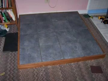

Had very good luck with the scotch brite pads and an old chisel. ( the side of it actually) Here is a picure of the finished product
Thanks to all for the help, Joe

Looks nice enough to take a nap on! :-P
Way to go Joe, it looks great! It'll look even better with the stove on it.

joe, that looks great buddy!
i wanna see what that 13 looks like on it with a nice fire going , but you can wait til it cools off some bro, besides getting a flue to draw when its 90 outside and 70 inside aint exactly easy. if you want to preburn the stove , do it outside , that will keep the smell of the oils burning off outside.

Looks Great!
Very nice Joe...you just saved yourself about $285 doing that...that's a lot of coin.
