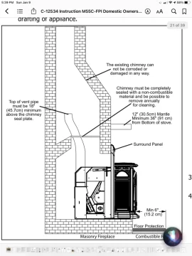

Yes good cleaning. You should not get any cold air from the stove itself if installed correctly. Do you have the owners manual, if not here is a link. Start by reading this..

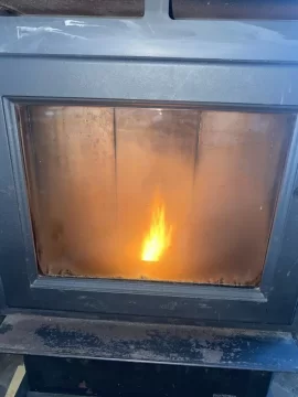

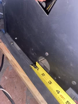

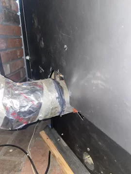

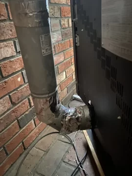

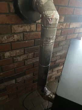

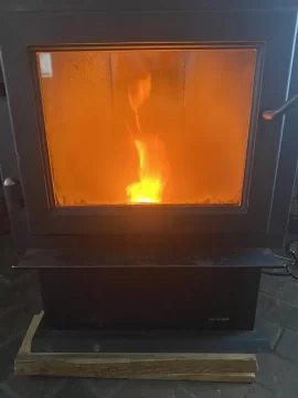

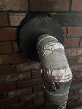

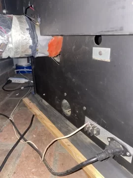

Alright. Here are some photos of the set up.
The flame is what we get for a few minutes, then it goes into a lazy flame and eventually peters out to a smaller flame until it’s fed pellets, then it goes back to a lazy flame. That’s on medium. On low the flame hardly comes out of the fire box. High is to much.

There needs to be a clean out “T” off the back of the stove, there could be a bunch of ash built up there impeding the exhaust…can’t see an outside air kit, that will also help, but not %100 necessary. A bit of work and I think it’ll work great.
Okay, I think we could get that going. I can work on researching that today. I thank you for that advice. I know there is a clean out in the basement, is the sufficient? Or should we have one directly behind the pellet stove?
How do we go about getting outside air into the pellet stove? I'm sorry I'm such a newbie!

A T makes it easier,but not required.What you have to remember is that section of pipe needs to be regularly cleaned inside,many stoves several times a heating season.Some take it off the stove, then slide from wall,take outside and run a flue brush through it. A T makes it so you do not have to mess with sealer at the stove or wall. All part of stove maintenance.

Yes the foil tape should work, some use a silicone tape too that’s also reusable and can be found at Home Depot as well…as Bob said the clean out “T” isn’t %100 necessary but it makes it easier to clean.

There are and were many different brands of stove pipe,just buying a part without knowing what brand would not be smart.
Also be aware, as not in your manual(stove manufacturers want you to use a certified stove repair/cleaner), is a few things, once a year,or more, remove the combustion blower,and clean it and inside the cavity.Clean the room blower. On your stove,remove the pot assembly,clean and lube.
As winter is here, My recommendation would be-read manual well. I would buy some silicone sealer,perhaps some foil tape. Defiantly buy a flue brush kit. Remove the pipe from the stove, and from the wall,take outside and clean well. Reinstall and seal,at stove and wall. Before doing this, take out all removable panels,clean stove.You will be able to reach inside where the flue pipe goes on. Wacking with a mallet is also fine,I prefer a rubber one. It can knock loose stuck on chunks. Then I would see how it runs. All this is only a little bit of work, and if you seal the pipe properly, you may not have to remove it till summer. Also doesn't hurt to have a dryer cleaning brush,to stick in places. Strong shop vac., brushes and sealer would be my purchases today. Tape if you think you need it.
That's my 2 cents. A little bit of proper work,and see if stove functions well/ok.
