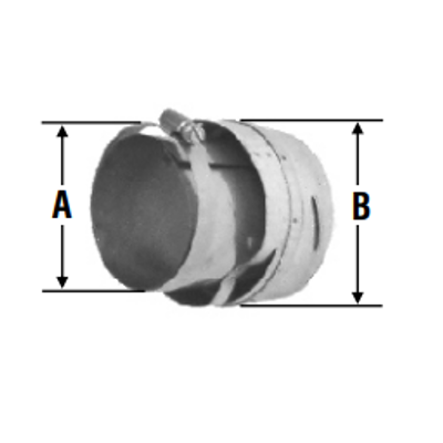

Next problem. We got the tee, same brand as the pipe we have now. How does this seal to the pellet stove. The inner pipe is the same size as the pellet stove pipe. The putter pipe is the same size as the rest of the stove pipe we have.
:sigh: this is a lot of fine tuning!
D885A7E9-6BBC-4816-9741-271DFED493CB.jpeg 8C831862-62C8-4471-9E0C-EBF4956B2F2B.jpeg

Hate to say it….Looks like new a new style Selkirk(T) and and older Selkirk appliance Adaptor that’s on the stove
johneh
Dec 19, 2009
3,852
Eastern Ontario
You also need a stove adapter
You must have removed the old one when you took the pipes apart
you should be able to reuse it. If it is not damaged
Washed-Up
Nov 5, 2011
873
Kananaskis,Alberta, Canada
Does the T screw into the old pipe male end? I could be wrong johneh, but I think the appliance adapter is on the tailpipe.
johneh
Dec 19, 2009
3,852
Eastern Ontario
Does the T screw into the old pipe male end? I could be wrong johneh, but I think the appliance adapter is on the tailpipe. Hear is. the part numberfor the pipe I see….if it is 3”
I think you are right the new style is a push on and turn to lock
for 3 inch it is a PL3Upa
Reactions: Washed-Up

Here is a blown up shot of the existing pipe from another photo she posted

Selkirk has the VP branded pipe and the PL pipe, it looks like.. Pic above shows VP..

Well, got the piping all figured out. Just had to use the old elbow but made it strait, it just pushed the stove more forward on the hearth.
