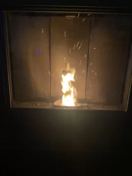

I have seen all of the lights. The blue comes on like you said when it first starts. Mine blinks like 6 times if I'm not mistaken. Awhile ago I did see the green light, but just checked now and it is red. There is a healthy flame on medium setting with a slow feed rate. I keep it on a slow feed because when it over feeds I get a lazy flame. It will still on occasion get lazy but it corrects and goes back down within a few seconds.OK The thermocouple is what changes the stove from start mode to run mode. Your snap switches do other things. See this-
See what lights are on and what they are doing. This is some built in diagnostics
I probably thought it was a ps50 when I started the thread. Checked the manual prior to ordering the first part and it is a 35.So I am confused,you had said it was a ps50, but now say it is a ps35? The reason I ask is if the control box is set wrong, it can overfeed pellets,and possibly not run right on all the heat settings.
I hear the noise, can't comment if it's unusual or something to be concerned about..Kay folks. It’s dying down. The auger motor is making a noise? The flame went from a beautiful flame, to this tiny baby flame that hardly goes above the fire box wall regardless of feed rate.
I am hearing this noise, never heard it prior to the new auger motor.
Hope I can upload a video.
Edited to add that it is not up to temp according to the thermostat in the other room, which is bizarre. Livingroom is reading 73 and the thermostat is reading 67 in the next room. I think I'm going to need a new stove soon.
I do not remember hearing this prior during all the testing. It just randomly started. Very bizarre. I turned the stove off because the flame just was not doing swell. I'll investigate today now that it is cooled off.I hear the noise, can't comment if it's unusual or something to be concerned about..
