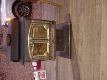

The lopi stove looks good but Im guessing it not the efficient style?
The pipe is 3 ' above the highest roof point. Ran the stove last nite again. It heated well but every time I opened. The door, even when it was raging, smoke poured out. I'm trying to decipher all the good info here.

I really appreciate everyones time here. I m going to experiment again tonight & post more info, I think we are getting close. The stove I have is 24 x 20" maybe its too big but I'd rather be hot than up feeding the stove with a new one. The guy with the lopi said he gets all night burns but I didn't ask if it was steel yet. The cabin is at 2600 ft above sea level & sits in a valley, woods on the left side & a 10' drop to a100' field & small river on the right then a mountain across the river the front & back are open lawn. If I add pipe it would sit 3' plus above the roof, is that ok? From earlier, yes the thimble is home made sheet metal & the studs don't allow it to be wider. Ill get a new one with new pipe but its not been an issue in 35 yrs
Looks like a decent Lopi. A wire wheel, some paint and probably door gaskets and you will probably have a solid unit. It may or may not be EPA but just the fact that it's an airtight stove can go a long way. Also with insulated pipe (assuming the chimney is still made in case you need more) that is a screaming deal. We will all be here to help you along the way :-)

So, I bought the lopi that was recommended on here & half the pipe I need, as with most Craigslisters the guy wasnt all that honest, including about the damper working. The knob isn't actuting the sheet metal "board". The stove is on its side so I can see it. I can fix it if I can determine whats what. There's a narrow slot underneath the stove where it is. Anyone else familiar with this? The knob only moves a tenth of a turn at present
.....actuating.
I should include the stove is circa 1982. The knob is on the front below the door & above the blower knob. I can't see a way to disassemble it as the slit underneath the stove is only 1" x about 10? Thanks in advance for any feedback

I guess I've gotten boring on here but have new info. The damper will move if the knob is pushed in but the knobs half moon is stripped. The lopi is a mh (mobile home) -440, I can only find a manual for a m-440 which doesn't have a damper knob. I don't know if I need a hole in the floor for draft or not. At floor level the backside is open an inch higher maybe to draair off the floor? Is anyone familiar with this?

...sorry, the pedestal is open in the back an inch high from the floor, maybe to draw air without having to drill a hole in the floor which could change the pressure in the building

I see, thank you very much. My stove has a knob above the fan motor knob that open & closes a sheet metal damper & a slit the length of the pedestal along the back. I wonder if that means I don't need the hole? I'm going to drill one anyway to maximize good draught. When trying to heat, cutting a hole in the floor just seems unnatural, ha!
At last im able to give back to the site. I spoke with lopi today they were nice enough to search their archives. If you have an early 80's lopi the only maual close to my model still around is for the m-440. I have a m"h"-440 which was made for mobie homes. This is good b/c the stove exterior is insulated for shorter clearances. Also I have a damper knob which makes it the mh-440 "t". Apparently u don't need a hole in the floor if u don't stuff insulation in the back at floor level as suggested in the manual. I plan to put mine on bricks to allow more airflow. If im sill having trouble I will do the hole. It seems like a great stove, hope this info can help someone sometime.
