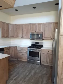

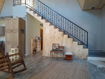

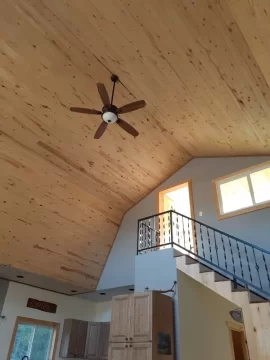

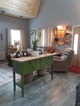

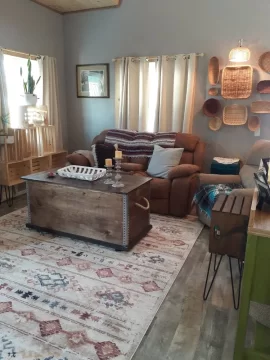

It's important to know how large of an area the stove will be heating. If there is an open stairwell then some heat will convect up it unless it is far away from the stove room. If the stairwell is open and close by, then it's best to include the upstairs area too.
Can you post a simple sketch of the floorplan indicating the proposed stove location, doorways, and stairwell location?
I attached some photos I took during move in.. The pantry cabinet will be moved and the stove and hearth will be there, unless the installer says otherwise. The kitchen is to the left. Hallway leads to a bedroom, laundry room, and bathroom. The dining area and living room are directly in front of the kitchen and stairway. Upstairs is the master bedroom and bath.
20220926_181700.jpg 20220926_181838.jpg 20220926_180647.jpg 20230308_141246.jpg 20230308_143335.jpg
View attachment 311450 View attachment 311451 View attachment 311452 View attachment 311454 View attachment 311455
Lovely! Go bigger than your square foot mage suggests. There will s a lot of volume there. Have you thought about locations?
