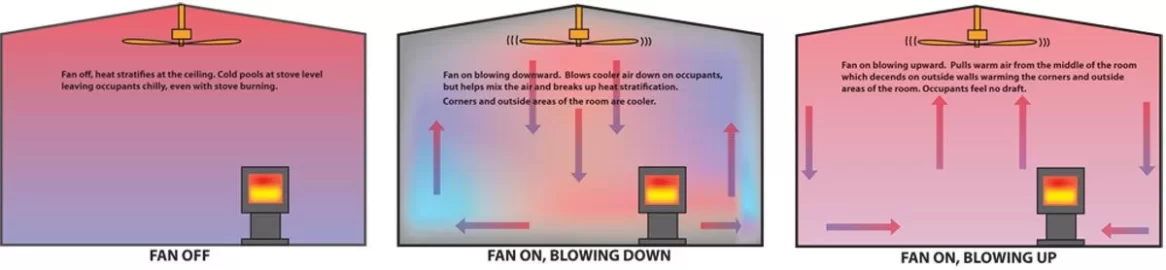

That stove should work great in there, I would think. Out in front, it will radiate well. Do you have a ceiling fan in the great room? If so, setting it to move air up should work well to break up the temp stratification in the room. Then a small desk fan on the floor in the back, moving cool air to the stove room, should give you pretty even temps throughout the house. Keep us updated....with plenty of pics! :)
The size of the house without the loft is about 1000sqft. The non-insulated ceiling and 23' peak was our reasoning for oversizing the stove. Chances are we will not be going with the F50 or F55.
The main thing you will need to do is keep the air moving and from stratifying at the peak. A ceiling fan or two will help a lot. I like to run them in reverse in the winter. That works well to mix the air and start a convective flow without drafts.

I ran my ceiling fans in both directions an was cold each time, I have one in front of the insert and one 30ft away in a kitchen, I received bad results, but that may be a later post for me in the future...
