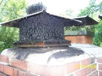

The key point is that the phenomenal number of new wood burners showing up this year need to understand a couple of things. Yes, given the presence of enough heat and air any wood will burn. Well, part of it will. But don't ignore the fact that a EPA stove needs wood in the twenty percent moisture range to burn efficiently. Efficiently meaning create good heat, not smolder and not crap up the chimney. Don't ignore that advice and then turn right around and accept the advice that says clean your chimney once a year. That only applies when burning good dry wood.
Ignore the first then you better ignore the second and keep an eye on that pipe because it will fill up with crap. Chimney fires are a rate occurrence with a new stove and a properly sized pipe or liner. Plugged up chimneys puffing smoke and CO back into your house are a frequent occurrence burning wet wood and every year here lots of people show up saying "Why isn't my stove burning right and why is it smoking up the house?"
Followed by them posting pictures like this:

BB, that is an awesome pic of a messed up chimney / flu / roof cap!!!! Did you take it or did someone actually post here asking what their wood burning problem was? Our webmaster was looking for come creosote pics earlier, that's the best I've ever seen IMHO.

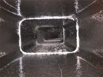

It was posted here. Several variations of it show up here every year. The best one of my chimney was when I had a cracked weld in my old stove right next to the flue collar and it was letting cool air in along with the exhaust gases.

The second photo you posted shows a chimney with a glass like coating on it which I know is creosote. I know this stuff will not come off with a chimney sweepers brush. What do you recommend for the removal of that glass-like coating? I have talked to several hearth com members and they have indicated that they plan on removing the spark arrestor screen during heating season. Woundn't the removal of the chimney cap in your first photo have helped alleviate the mass build up of creosote? Many chimneys dont have caps...So besides keeping birds and rain out of your chimney wouldn't removal of the spark arrestor screen allow for a longer interim from having to clear away debris, at least at the chimney top?
That is an excellent question and one I often wondered myself. How do you get this stuff off? It attaches like a ceramic glaze and you can' t even scrape it from accessible surfaces
