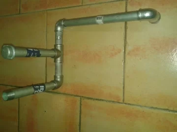

the second test is ok
seems to go a bit better the flames came out of the secondary
but they had little power (perhaps too many holes)
the tubes were almost secondary red (stainless steel) and then the temperature is ok
Maybe try again with 40 - 3mm holes? (20 in each pipe)
ok try 40 holes 3 mm
currently the holes are arranged in three rows for pipe

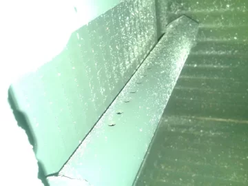

[Hearth.com] information about the secondary air inlet tubes measure
okay o 'better put them on one or two rows
It is easier to drill more holes and than it is to remove holes. Try drilling just one row of 12 - 3mm holes on the bottom of each secondary tube (facing down). Test that and see how it works.

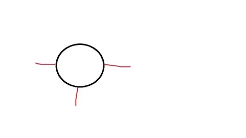

I also believe that it is important to have a lot of pre-heated air inside the stove as an accumulation do not know explain seeds
in my case the 30 mm tubes are small air goes directly to the holes in the tube and heated on the way
I reflect now because in addition to reducing the holes for me that you have to create a place accumulation of air inside the stove
Get rid of some of the 90 degree turns to improve air flow.

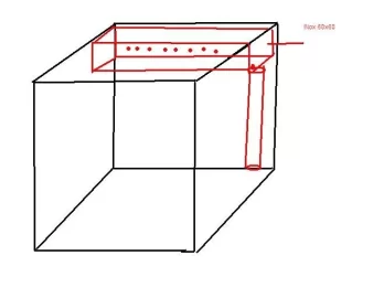

E non da solo ONU Problema di curva di 90 Gradi. Bene e Necessario preriscaldare l'aria e in Grandi quantita, in Un tubo da 30 millimetri C'E ONU Sacco di spazio
tubo di 30 Millimetri Lungo 30 cm (0,2 litro d'aria)
Acciaio inossidabile tubo quadrato 60x60 Semper Lungo 30 (1 litro d'aria)[Hearth.com] information about the secondary air inlet tubes measure

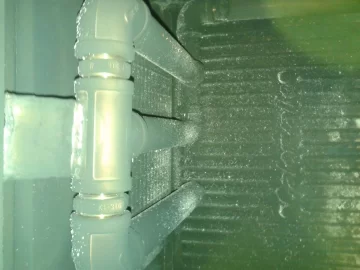

Did you try burning in the stove with this pipe configuration?
Try it, but with less holes (12 x 3mm) in each secondary pipe.
