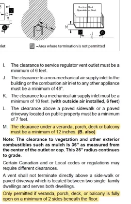

What would be the best install for the following situation:
Looking at getting a pelpro stove, will be installed on exterior wall of house. Problem is that it will vent onto a porch with a roof. Do I need to go out the wall and up through the roof? The manual shows a pic of a straight horizontal install but says they recommended at least 5 feet vertical rise. Trying to keep this as simple as possible but also don't want to take short cuts. Any help would be greatly appreciated.
