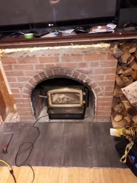

installed with a problem...
If you
If you are happy where it sits, hell, take an angle grinder with a diamond blade and cut a notch where the rod needs to slide out to, give yourself the room you need, and be done with it.
You'll be okay open up top for now, but you will want a top plate, storm collar and cap to finish it off.
Agreed on doing a variation on this. An angle grinder won't take the notch deep enough but if I could cut off the L handle and drill a hole through it'll work.
The length of the rod is roughly 6" longer than the photo. So about 8" total. Tough to say because I'm not gonna move it anytime soon.
Was planning on tomorrow afternoon or maby the weekend to put the cap and color on. I have the hardware.
Very cool looking fireplace. I'm with Hog, grind a notch. Or, is there room for an offset made of two elbows? This might be a rigid 30º pointed rear, coupled with a 15º liner elbow pointed upward into the throat of the chimney?
Honestly it was such a pita to get it hooked up like this that the thought of taking it apart to attach more corners is not something I want to do.
The more I think about it the more I want to make a notch. But I need to be able to make the notch deep enough and I think an angle grinder won't go that deep unless I make a huge notch...like a brick sized one.....
my experience and knowledge on the topic of grinders is still growing so you may be thinking of something that I'm just not imagining due to limited experiences.
A larger angle grinder will. If not, rent a gas saw with diamond blade and you'll easily get more than a brick thickness out of that blade.
If you cut off the bend, how will you grasp the rod? Does it get very hot?
Agree with Hog. Rent a big one if you need it. This will make a lot of dust so plan accordingly.
Long term have you considered getting an insert with a narrow width, but a deeper firebox? That might solve some issues and provide more heat, longer burntime if that's is a consideration.
Reactions: beermann
Hate to tell you this, but you're going to have to move it to either cut a slot, or drill a hole.
Reactions: beermann
I'll need about 5". The brick is 8".
If i cut off the bend I would drill a straight hole through the brick to the left and attach an additional rod to where the rods bend used to be. So the rod would run straight through a 1/2" hole in the brick via an attachment where the L handle gets cut off.
I agree. And had I been able to shop around I may have gotten a different model. But this unit was a freebee and generous family members bought me the liner.
Take pics and let us know how it goes.
Reactions: beermann

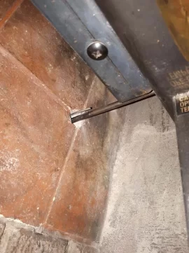

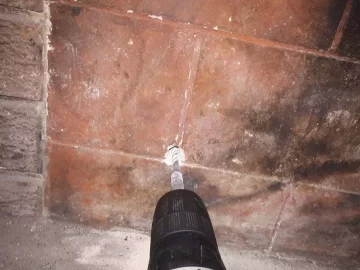

Post on beermann's behalf:
Notes:
Drilled a hole all the way through the left side of the fireplace bricks. Pushed a clothes line through and I will crimp it against the handle of the air adjustment rod. I also ground off the L handle so it fits perfectly in the hold I drilled.
Here are some pictures
Notes:
Thanks and to clarify the clothes line thing.....i meant to say a clothes hanger.
My bad.
