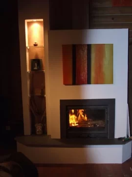

There she blows ! It got cold one night so we fired her up.

Back again with another quite pressing question.
Had the fire going this morning as the morning chills are getting colder. I noticed as the fire heated up there was a smell of something burning/overheating. The stove pipe that was fitted from the insert to the chimney is actually what looks like flexible flue liner, and not of a high grade, and certainly not solid stove pipe as I know of it (what little I know). Parts of it were actually going purple/blue with the heat, and I think it was this that was giving off the overheating/burning smell.
