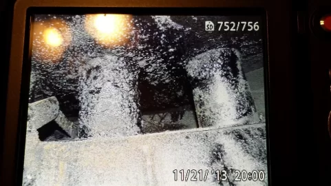

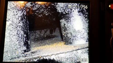

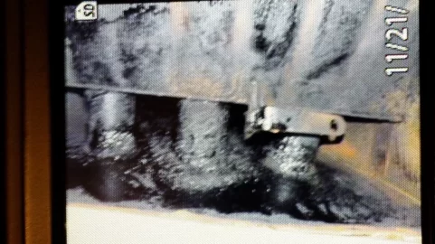

I've been planning on installing a wood insert into my fireplace. It has a heatilator installed. The problem is if I cut the tubes I still only have 5" wide then about 6" higher
at the flue it gets even smaller. Maybe 3 1/2 to 4" wide. What are my options for this? The stove I wanted to use requires a 6" liner. Sorry for the poor quality pictures.
Thanks for any advise

Well, one option is to cut, grind or remove (in some ways) one or two of the tubes....and even some of the frame from the area about that. However, if you have a full 4" or more in the above frame, it might be easy to oval some flex pipe a bit to get through it.
Of course, this means the fireplace cannot easily be brought back to "stock" open use, but chances are that it's near the end of it's useful life anyway.
Another option would be to reach up and grind out the damper area to the full 6" or more and then just ovalize the pipe through the 5" tube area.
It wouldn't be a bad idea to hang a metal etched (engraved) tag of some sort up there from one of the tubes stating that the fireplace has been modified and should be inspected and fixed if ever used as a open one again. This may help someone in the future!
Nothing to add except that the chimney looks like it must have a professional cleaning before installing the liner. There is a lot of creosote showing there.
I usually cut two of the tubes out with a sawzall and bash them out with a hammer if needed. Then on the "box" area where the tubes connect I cut a half moon into the face of it with a torch, giving me access to the back of that area to cut out my other half moon to get a 6" liner through with plenty of room. I would also vote for a VERY good cleaning before installing the liner as well.
Reminds me if my installation , I had to remove the center tube and cut the damper out .
