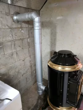

Yes it’s safe. But it is not optimum for the functioning of the stove. If your stove evl is more than 15’ it would require 4”. Hit the forums search for EVL and there is a lot of info to read about your installation, not to mention what the installation instructions are in the manual.
I read up on EVL and I did some calculating what the EVL would be if I go all the way up to the chimney cap, it came around 30 EVL and at 2,900 above sea level. The graph in manual show to use 4" inch pipe.
Is it optimum enough to use 4 inch pipes to the chimney nimble only or I would still need a 4" liner inside the chimney all the way to the chimney cap?
Thank you for the education and feedback!
