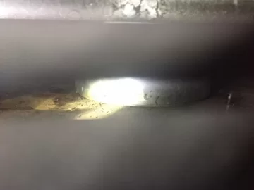

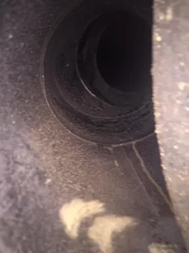

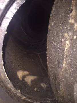

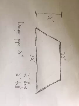

1st - Is this a liner in there already? I tried to take a picture of the exterior of it through the vent. If this is a liner and will work, is it as simple as finding an insert that will fit and getting an adapter piece to mesh the liner and stove together??

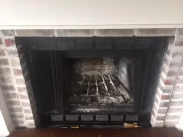

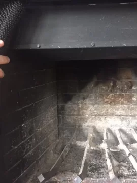

2nd - Do I take the firebrick out if I put a stove in? I drew up current design of how much space I have, not much. I'm assuming I will have more if I take those firebricks out, they are just like a thin slab that doesn't look difficult to remove.

Looks like a ZC fireplace with a metal chimney. The mfg. name and model tag may be somewhere on the door frame.

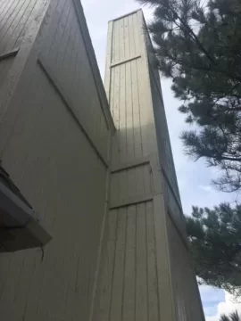

Yes definatly a zero clearance unit. Most dont allow inserts. And yours looks like it has been used pretty hard. And i see signs of water between the walls of the chimney. It needs a cleaning and full inspection including removing the case cover to inspect inside.
I found the tag. Says Martin industries on it and has model number bc4250. It may have been used hard in the past. I think the water is probably from the cap above looking like it has seen better days.

Well i looked allot and cant find a manual for that model number. But i read 7 other martin fireplace manuals and they all specifically say do not use fireplace and chimney to vent a stove or insert. Without finding your exact manual i cant say for sure but it seems unlikely an insert is allowed in that fireplace.

Yes you could remove it and either replace it with a high efficiency wood fireplace. Or you could take it all out and turn the space into an alcove for a freestanding wood or pellet stove. Or you could leave it and put a stove somewhere else in the house.
