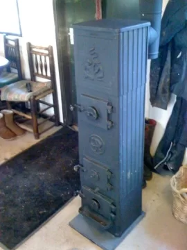

As requested, a beauty shot...

  • [Hearth.com] interesting Jotul 505

Nice. Looks like a tower of power. Thanks for the picture. Let us know what you think the best way to run the stove is after you've had a chance to work with it.

Holy crap, that's cool looking!
Nice. Looks like a tower of power. Thanks for the picture. I suspect this is primarily a coal heater. The numbers are so that you just dial in a running temp and walk away. I am curious as to how well it will burn wood. Try using the middle control for this and see if the fires last longer. Also check the flue to see what setting gives the cleanest burn at various stages of burning. Let us know what you think the best way to run the stove is after you've had a chance to work with it.
