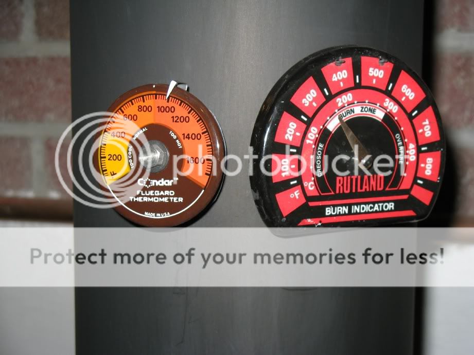

That's normal for me to get up there once in a while. While I think these condar probes are precise (consistent) I think their warning zones are set too low IMO and here is why. One of these is lying (the rutland was confirmed accurate by my IR gun), and if I thought it were the rutland then my stove top would never be able to go over 475 degrees as anything more than that and the condar says my stack is too hot.

Pen have you tried that Rutland on the stove top? On the pipe, because it is so big, a lot of convection air is pulled up through it.

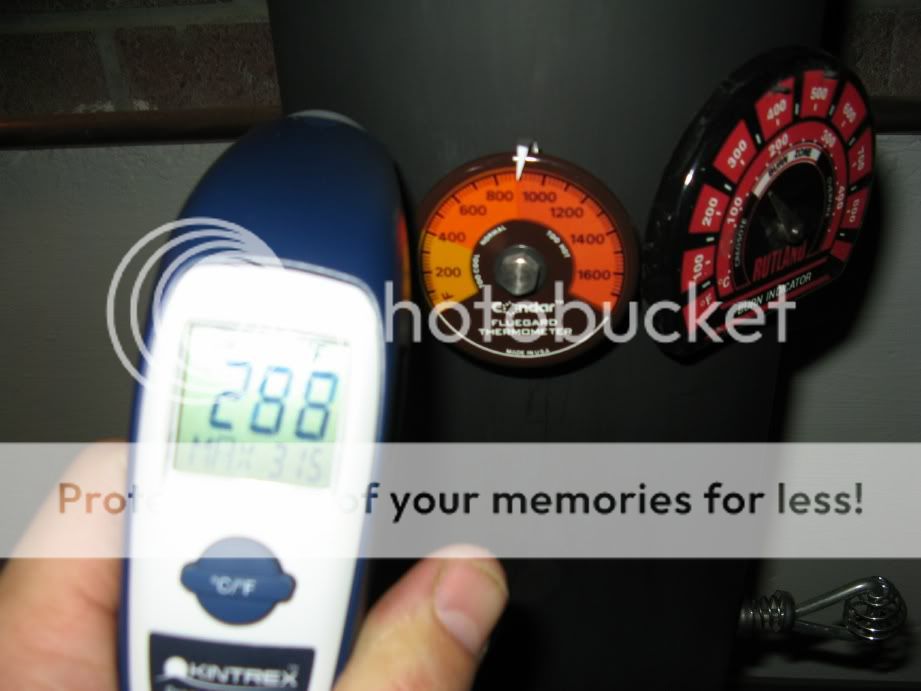

BB, the rutland and my IR probe "think alike" both on the stove top and on the pipe. On the stove top, the rutland starts losing it's marbles at about 600 and up when it will begin reading about 50 degrees low
If you look at the reading on my IR here and the max listed blow it , you can see the rutland's not doing too bad.
[Hearth.com] Is 1200* dangerously hot?
At the end of the drama post I linked to / referenced above, condar swears these things are accurate. I agree that they are precise and may be accurate in their thermocycler but I don't agree that they are accurate on single wall pipe as their instructions would lead you to believe. I think the extra radiant heat from the single wall causes problems for them. I still use it because I love how quickly it registers and I feel it reads consistently (precisely) however I think that when it reads 1200 on single wall piipe it is actually much cooler inside the pipe.

Just to clarify (since it isn't visible in the picture): the digital IR you're holding in your hand has a probe that extends the center of the flue, next to the Condar probe?

No, it's a surface temp. That picture was taken to confirm the temp reading on the rutland and to discredit the claim of condar that their flue probe would read 50% greater than surface values. I say, no way in hades for single wall pipe and condar confirmed that by saying that my probe tested accurate yet it is no where near what they claim I should be seeing on my actual stove.
