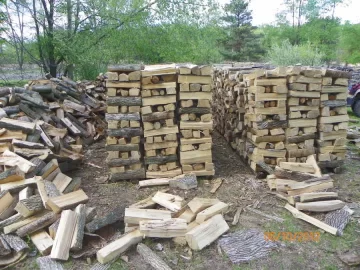

Let me see if I ge this right.... You buidl 4 "towers" - two on each side and then you just pile the other wood in the middle so it is supported by those towers?
Pretty much . . . although I find most of the stack in the middle supports itself if you do it right . . . there is not a lot of pressure on the end cribbing. Also, I tend to build the end cribbing as I go along vs. building them first and then filling them in. As I stack up the wood gets pushed in a little so there is a bit of a lean towards the middle . . . seems to help as the wood shrinks from drying.

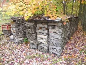

What does it mean to do "cribbed ends"? Can you show a photo?
[Hearth.com] Is my stacking plan any good? [Hearth.com] Is my stacking plan any good? [Hearth.com] Is my stacking plan any good? [Hearth.com] Is my stacking plan any good? [Hearth.com] Is my stacking plan any good?
Here we simply cut some saplings in the woods, lay down two of them and stack the wood. We do our splitting and stacking in the spring. Stack at 4 1/2' then wait. Usually around the first of December, we then top cover with old galvanized roofing. As you can see, we usually stack 3 rows together and they are 9' rows because the roofing is 10' long. This has worked well for many, many moons. We also try to always stay at least 3 years ahead on our wood piles. Doing this, we use less wood to get the needed heat and we also keep our chimney clean without having to brush it very often.
