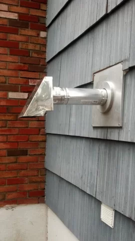

IS the cap on right????

Here is the pic forgot to up loaded

Vent cap looks good but you might want to silicone around both the exhaust pipe and thimble.

What is that small white grill below the vent?
:)Gotcha. Kinda looked like fresh air intake for the house. Wouldn't want exhaust blowing into that
My OAK is right next to the vent about 12" away.
