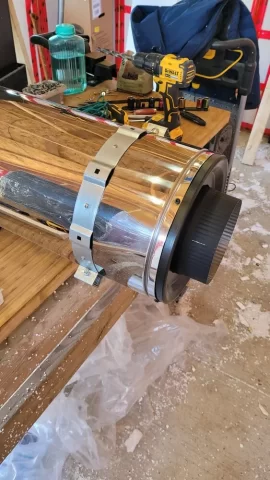

Is this all i need for the install?

I called them and said I need to install a band and tighten it which holds it in place through the support box

Thank you for the response, what I didn't get from the beginning is how do I put the chimney into the support box. I watched so many videos and it seems selkirk does it differently. I have to put a band around the pipe and screw it into the chimney then lower it into the support box leaving 4" exiting the support box.

Maybe that’s what they are doing now. Mine is just sitting on the support box. I’ve physically lifted the chimney disconnecting the pipe before. My pipe pieces thread together and then there’s a clamp like a hose clamp that fits around them.

Ya it seems pretty easy now, I just thought it was one way and never seen it done this way. I'm excited again about trying to do it tomorrow

I'm thinking must be tough supporting the chimney to the roof while it's just simply sitting on the support box. Would be better if it screwed into the box like other company's do.

Mine has worked just fine as long as it’s been there.
The sheer strength of the screws holding it in must be more than enough.

Your install sounds interesting. My Duravent ceiling support just screwed to the side of the support members that I built for the support box, then I just lowered the chimney down into the support box, gave it a twist - done. Locked into place. Obviously I had the hole in the roof and the flashing already in place, nailed, shingled. From there I installed my interior pipe using telescopic pipe, installed my screws and was done with the install in about an hour.
