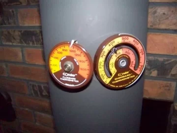

I just installed the Condar probe into my double wall about two weeks ago. It will go from 0-1200deg. in ten minutes if I leave everything wide open. I thought that was normal, now I'm wondering if it's actually that hot.
If I did what the manual stated and filled up with kindling and then small splits and ran wide open to establish a coal bed, the Condar would indicate a melt down-I suspect-maybe even send out a 911 to the fire department. I do have to trust it somewhat though. No other choice.

I cut mine down to a 3" probe so it's smack dab in the middle of the pipe. I still get the same high readings, doesn't make any difference. This is on sigle wall pipe. 1st pic is in the bypass mode, the internal really takes off and is more than double the external temps. 2nd pic is about 1 hour after engaging the cat the internal settles down to just about half the external.
  • [Hearth.com] Is this Flue Temp Probe Full of "It"?
My experience has been that higher temps (above 500*) are more likely to produce greater inaccuracies...
Peter B.
Another thing to point out in my 2nd picture is with the magnetic external thermometer I'm barely in the good burn color coded zone which starts at 250, in fact after a couple hours it usually drops below. The internal probe I'm right in the middle of the good burn zone.
