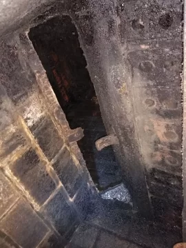

Ok here's some pictures I took today. Thankfully i was wrong about the flue size. I might actually be able to fit a 6" insulated liner. The tiles are 18*13 with an inner dimension of 15 3/16” * 10 7/16”. So that said this may not be as difficult as I initially thought.
The bad though is from the bottom of the smoke deck to the top floor tile is only 10' 11". Very short chimney overall. View attachment 230446 View attachment 230447 View attachment 230448
Yeah that will be a really easy fit. But you need to get all of that glazed creosote out of there first.

No it is zero clearance to combustibles on the other side of 4" of masonry. It will not be cool to the touch and in the event of a chimney fire it can be hot enough to ignite that creosote. Then you would have a fire between the old liner and new liner which is very hard to put out.
Easiest way to do that?
I would start with a rotary cleaner with chains on. If that doesnt work it would need chemically cleaned.

Wow that smoke chamber is a mess. That is going yo be tough to clean
That is short. Will you be extending it? What insert will be going in here?
