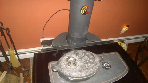

  • [Hearth.com] Isle Royale Smoking... a lot

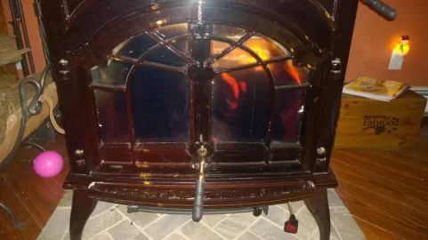

I don't have a manometer so I can't respond to the readings other than temp. 725-750 is getting on the high side for sustained temps. The stove can handle it, but I don't think I would run it like that as a constant. I can see premature failure of internal components like the burn tubes or the angle iron holding the back bricks in, etc.

Not all of the time but I'd say at least 90 percent of the time the stove burns starting from the rear right corner, for what its worth. The picture I have posted is typical.

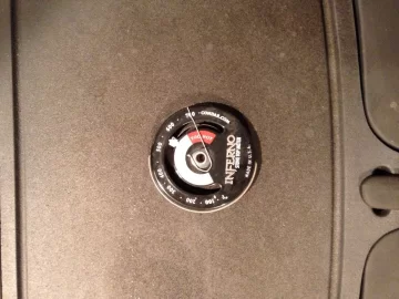

For what its worth My Inferno stove top gauge reads 50 -75 deg high and I level out about where yours is in the pic so I guess it runs around 675- 700. My pipe doesnt run redlined tho I can keep it at arounf 700 as well. I've got the big round hole underneath covered halfway with tinfoil and magnets, not dure if it affects it much as there are alot of gaps underthere for air to get in but if your key is closed, slider is closed, I'd try to cover that hole. I follow these post close as I try to gain knowelge from other owners on here, I see Isle Royale in the subject and get all pumped up!!
Reactions: UPswede and js156
Also, the paper clip trick I lernt about on here works great! Puts my mind at ease when I come home from work and can see it didnt climb out, also makes it easier to see when it levels out.

[Hearth.com] Isle Royale Smoking... a lot Just straighten out a paper clip and set it on like so, the needle will push it around and leave it where max was, I'll have to try to calibrate mine someday, thanks for the tip

No pipe damper. Slow burn. 500 degrees. Wood charred in front, wood uncharred in back. Air 90% closed.
