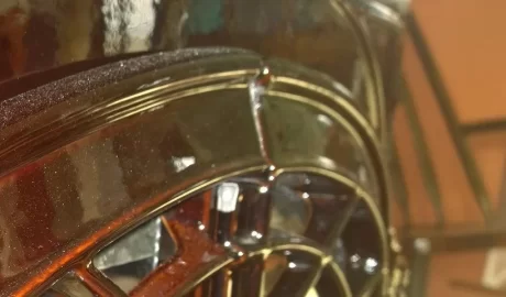

Here is a picture of my door. If anyone can tell me if this looks out of ordinary or about what theirs looks like I'd appreciate it. It closes as I would expect at the top but the bottom less so.
Also, some time ago I was outside and noticed ash on the top of the snow. I don't know what to make of that.
Naturally with both of the issues I am worried about my previous overfires being the cause for both. Thanks. [Hearth.com] Isle Royale Smoking... a lot [Hearth.com] Isle Royale Smoking... a lot

Hard to tell if something's wrong with doors from pics. I wonder if serviceman used correct size gasket; sizes are in manual. Wrong size could cause leaks.
Those door gaps are maybe a little more than mine, buy I have had years of squish on the gasket to bring them in line. I don't really think its and issue. The right door overlaps the left with a pliable material in between (gasket). It could/would be pretty difficult to make that perfect.

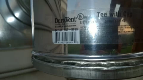

Well, my dispute with the credit card is on going and has yet to be resolved but I have a question as to the cap on my Tee. I can't get it off to look inside the chimney. I have tried to turn it as the arrows on it tell me to but it won't turn. I have tried to pull it down but it doesn't even budge. If I continued, I would pull the handle right off of it. I have even used the claw of a hammer to try to pry it off but no luck.
Is this common? If not why is it happening to me?
Thank you all very much.[Hearth.com] Isle Royale Smoking... a lot
It's Hard to tell but in the pic it kinda looks like there is silicone in there. I could just be dented up a bit from the hammer?
They can be tough to remove sometimes.
Also make sure that there is no screw in it anywhere.
That's good. I was concerned that with the stove overfiring that maybe the chimney got damaged. One less thing to be concerned about. Maybe if I spray it with some WD40 it will come off.
Thanks
Ya, we use WD40 on stubborn slips pretty often. It works very well!

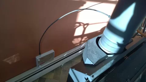

I have a chimney damper coming as well as 48" ss chimney pipe, to get my chimney up to 2 feet above my roof within 10 feet, but my question is with the chimney damper.
How will I know how closed to keep it? Should I use a chimney pipe thermometer having a stem or should I use a manometer attached to the chimney? Or a combination?
I'm looking for something simple and efficient I guess. Thank you!

I have installed another 3 feet of chimney pipe outside to help reduce the downdrafts and it has worked well so far.
Also, on the inside, I configured these 5 parts to control the draft. I had a challenging time finding the parts I needed so if you should see others with this same problem (moderators) please feel free to direct them here.
I have only had this operational for a day and I am surprised that my stove has reached 700 with maybe 3 logs in it. Just so there isn't anything wrong with the stove itself.

Hi again there js. I've followed your struggles right from the beginning, and I'm really glad that you stuck things out! I think everybody struggles a bit when the start out burning in these new stoves, but man oh man, you had the tenacity to overcome a monumental struggle. Right on! Now I'd really love to see some pics of your new stove set up with the manometer and damper.....
Hi Chuck!
I just took a picture of my set up. It was easy once I had the parts and I hope when the next person comes down the pike it will help them out too. If they order expedited shipping they could have them all in a week. The hardest part for me to find was the mini barb connector but eventually I found it.
With the static pressure tip, (part 1) I did cut off the bent area and now have the open tube going into the chimney 6 inches above the stove (as per the manual) because I thought the 4 tiny vent holes would clog with soot quickly.
The plastic tube connecting the mini barb to the manometer came with the manometer kit.
Have a good day!
I just noticed that my damper is not showing up on the picture. I have that at 13 inches above the stove. I also changed the pipe on the inside of the house from double wall to single wall; I have the clearance. :)

That looks pretty cool js. I hope it helps you control the stove. Stay warm! :-)
Hopefully, you can use the modifications to your advantage the way that kobeman outlined in this thread. You've got a lot of chimney. That means a lot of draft when temps get cold outside.
Reactions: js156
I did just read kobemans post on page 4 one more time and will revisit that while it is becoming habit.
With my damper closed my manometer is now reading .07. To help get this number low I think I will be buying some fire proof caulk to close up the 4 holes that go through my damper. I guess this is because my chimney is 24' high outside plus 4' inside? Right now it is 25 degrees outside. (toasty inside though :) )
I thought I wouldn't need a stove pipe thermometer since I have a manometer but I guess that is not the case. I will get one. Thanks Kobeman.
