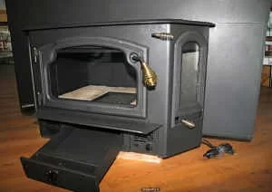

Does anyone HAVE the Sierra Ambassador 4700TEC or know anything about their stoves? I haven't seen a lot about them but it looks pretty nice and is being offered for $1299. Here's what the website says: ((broken link removed to http://www.sierraproductsinc.net/pages/woodstoves.htm))
"Sierra Ambassador 4700TEC bay window fireplace insert offers more than just great looks. It is truly a whole house heater with standard feature including wide angle view of the fire, glass air wash system, ash pan, great, and high output thermostatically controlled blower system. This long burning catalytic insert will hold 24" logs and heat up to 3000 sq/ft."
It says it has a thermostat (like the BK stoves?) and an air wash system which I believe most cat stoves don't have right (i.e. dirtier windows)? What does it mean when they say: min flue draft is .06wc in the "Dimensions & Specifications" link at the bottom of that sierra website (bottom left)? Does that have something to do with going from an 8" flue to something else?

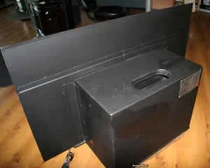

do they make a liner adapter to match that flu opening looks rectangular
Quote "It says it has a thermostat (like the BK stoves?) and an air wash system which I believe most cat stoves don’t have right? What does it mean when they say: min flue draft is .06wc in the “Dimensions & Specifications” link at the bottom of that sierra website (bottom left)? Does that have something to do with going from an 8” flue to something else?"
The thermostat it is talking about is for the fan. Just means the fan will come on when enough heat is produced and it will go off when no heat is produced. Cat stoves do have an air wash system some are better than others depending on how old the unit is.
That is a $2,500 heating beast right there. If that guy was around here that stove would be on my truck tonight. The thermostat isn't for the burn it is for the blower fans. .06wc is a measure of the chimney draft and .06 is a pretty normal draft. You would use an 8" oval to round adapter to connect it to a 8" liner.
It is a different company now but I burned in a Sierra pre-EPA insert that size for over twenty years and loved that stove.
The .06 wc is referencing a pressure requirement within the flue for the draft to function properly. wc = water column, which a unit of measure.
Be advised that those are pictures copied off of zoobler.com.

And yes they make an adapter that goes on that rectangle and converts it to 8" then you get an 8" to 6" adapter and run 6" flex up your chimney, as long as your chimney is tall enough for it to draft well.

The weird oval opening on the back seems like it would be difficult to get a good seal on without doing a lot of caulking &/or stuffing of an intermittent gap where the oval shaped metal connector piece goes into the oval hole.
The cat can't be seen like on other cat stoves because there's a big steel plate "box" bolted on the top where the cat "supposedly" is. I'm a little concerned by the possibility of the 2 nuts and bolts being hard to separate (to check cat) after yrs of firebox use. Here's one for you: The guy said the location shouldn't be an issue "especially since the cat shouldn't need to be serviced/replaced for at least 20+ yrs"... He's a former chimney sweep too.

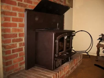

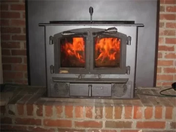

Here is that stove's T-4500 "smoke dragon" grandaddy in all of its 650 pound glory. It had an early secondary air design that feed the extra air in over the top of the door glasses and under the baffle to crate a floating blue cloud under the baffle that I glanced back at before going up to bed for 21 years. 4.3 cubic foot firebox, 1/4" stove body and 3/8" plate top. In 2006 it ran away on me and I discovered a popped weld in the back of the firebox hidden by the baffle. In fact twenty minutes after the pic was made the stove top was at 1,425 degrees. The paint on the thermo and in the middle of the top plate vaporized at 1,185 degrees. But nothing on the stove warped. I still have it out back. I pulled it out of the fireplace the next week and rolled in the 30-NC because the weld was inside the shroud so it couldn't be re-welded and the stove owed me nothing after heating this joint for all those years. PS: At a stove top temp of 550 degrees the chimney exhaust was always clear as glass. I just busted the stove by burning too may thousand degree fires in it and banging N/S big splits against the back of the firebox too many times.
I would give that bay window cat version a run in my house in a heartbeat.

BortherBart, that looks like a beast. It sure looks built heavy even in the pics.
Steve
Steve
Yeah and that is only half of it out in front. :ahhh:

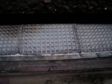

He's full of it! You need to take the cat out and brush or vacuume out the fly ash about once every cord of wood burned. Cats usually last about 3-6 years more or less depending on how the person burns their stove. Dry wood and proper maintenance will extend it's life but 20 years is very doubtful unless you are an ocassional burner. I've never seen the insides of this stove but it sounds similar to the Country Flame BBF and it's pretty easy unbolting the 2 bolts to remove the baffle and the cat should just slide out, maybe a 15 minute job.
Todd, Iam on year five, 30+ cords of wood and never pulled or vacumed my CAT only lightly brushed the face with a paint brush.
This is a pic on year three and still looks like that on year five.
