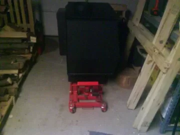

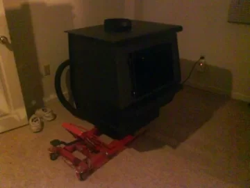

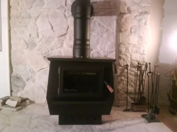

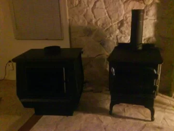

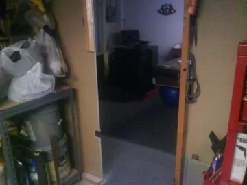

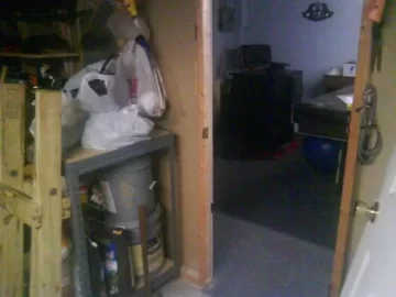

Here are some pics of moving this beast. 1) I tilted the stove on end and slid a motorcycle jack under it. 2) Modified door way so I could get the stove through. (Non load bearing wall) 3) Repaired door way after getting it into other room. You can see it sitting next to my pool table. 4) Simply rolled it through the other door way without modification into hearth room where you see it sitting. 5)Tilted it down on to a short 2x10 on hearth next to old stove. Big size difference 6) Used a second 2x10 and slid it across the hearth into position and hooked it up.
