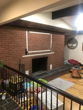

Hi all, first time poster here. Thanks in advance for any advice. I finally replaced an old Gold Marc wood insert and am upgrading to the Jøtul c550.
Now that I have viewing glass, I’d like to make that wall more of a focal point of the room. I’d like to install a mantel and move my television onto the brick.

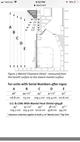

My question is concerning the clearance needed, type of mantel you’d recommend (wood or possible stone?) and whether m or not it’s safe to put the mantel and TV on the brick above the insert. I tried to attach some pictures, I hope I did it correctly.
I'm concerned with how close the mantel will be, but if I’m reading Jøtul correctly, I should be able to use a 5.5”(depth) mantel with their heat shield.
Does anyone have any experience or thoughts on this? Thanks again,
Mike
Just my non-pro opinion. Even if you went with non- combustible mantel, at that height ( in your pic) items you have on the mantel are really close to the stove. You may find that having a mantle at that low of height may look odd too.
Sit in a chair and look close at your neck angle watching a TV that high on the wall. Then think about speakers for a HT application. The center needs to be as close to the TV as possible BUT more important they should be placed at the listeners ear elevation.
Because the blower moves the heat out into the room the TV probably will not be effected by the heat but I have a 3" thick blue stone mantle above my insert and it does warm up a bit but I never looked at the temps above the mantle.
Thank you both for the replies. Definitely considered head/neck angle, luckily it is a fairly spacious living room so the couches are far enough back where it is actually pretty comfortable viewing. I suppose my main concern is space between top of insert surround and the mantle.
You will be ok with a 5.5" mantel using the heat shield as long as it meets or exceeds the manual's minimum requirement.
Mike
