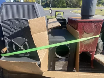

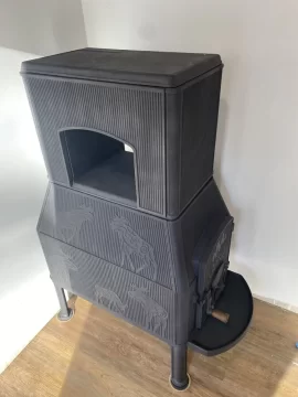

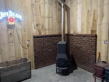

Thank you @WarmerWithWood for giving me the opportunity to give this stove a new life! We are so excited to find this gem. A unicorn or Sasquatch really! Thanks for the wonderful experience! You are truly a gem, just like the stove!
[Hearth.com] Jotul 121 Elg [Hearth.com] Jotul 121 Elg [Hearth.com] Jotul 121 Elg
Nice! That's a big heater. Is it new, or just repainted? Looks like you got a full load of old Jotul gems.
Used. They threw in a red 602 that’s got some cracks.

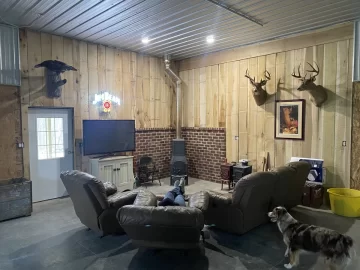

Are you going to put that big boy in the house?
It will go in the garage once it gets built. I recently moved and the house doesn’t really have room for a stove. I’m in the process of installing an FPX Apex 42 though.
Just a wonderful transaction with good folk. We are happy to see the old Moose continue on. I guess it’s time to change the profile pic.
The Progress Hybrid is providing a great transition so far - the dancing flames are a bonus and the heat is almost too much, at least for this shoulder season.

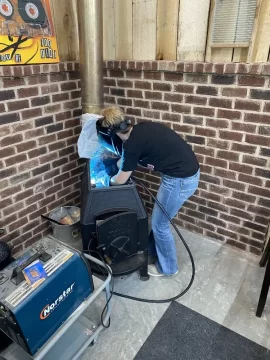

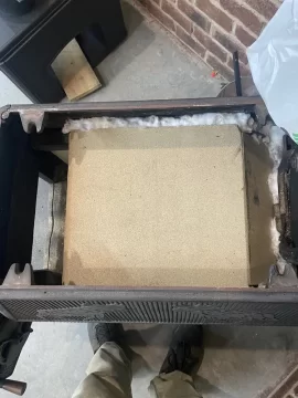

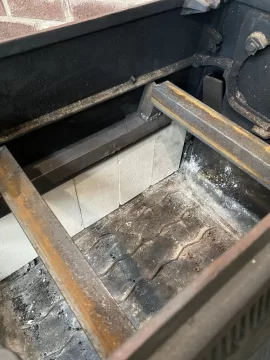

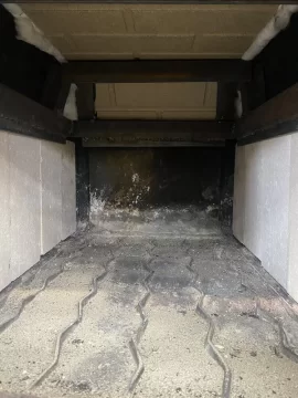

I finally got around to fabricating some replacement side shields and baffle. I think it turned out pretty good. Firebrick for the sides, skamol for the baffle. The piece I had was a little narrow so I stuffed the edges with ceramic wool. Being a prototype I used what was free. Thanks to my daughter for the welding. She chose this as her vocation in high school.

Very cool, nice job!

Keep us posted on how it works out

That came out really well. How neat that you and your daughter could team up on this project. It looks great.

I thought about for a year and finally made it happen. Should work great. The rear panel is still intact, it channels secondary air above the baffle. For an old stove these burn incredibly clean.
I'm looking forward to hearing how it works for you. The 118 has a good track record so this big boy should be even better with the new fittings. Remember to put an inch of sand on the bottom before burning.
Is the door also designed to inject secondary air at the top where the flue gases turn around the baffle?
No, it sends air under the floor and up the back wall, then it moves out across the baffle.

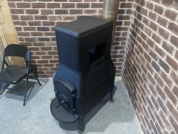

It’s just a garage stove. But very rare and I want to protect it as best as I can.
Looks more like a man cave stove to me :)
The heat exchanger makes it rarer. How is that for creosote buildup?
You might say so. Still just in the garage though. Very little creosote in the heat exchanger. I clean several old jotuls regularly. Very little buildup on over 2 years. It’s pretty incredible really.
