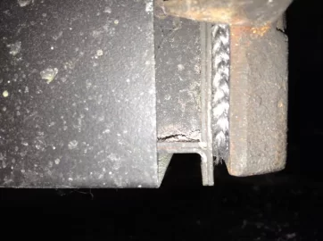

This photo with flash looks a little funkier at the bottom of the ash pan than it does to the naked eye. I don't know if the camera is seeing a little better than I am.
I guess the gap between the main housing and the drawer is supposed to be there?
