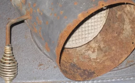

I'm chuckling because Condor, a catalytic combustor manufacturer, lists a combustor for the 3TD. However, I have yet to find anyone that has one that is set up that way. I think that there may have been a few TD's manufactured that way in the early stages of Jotul's brief journey into catalytic stoves. The combustor is on a wire frame that allows it to pivot which seems to indicate it's positioned at the flue opening. I have how ever yet to find any other evidence of the actual existance of this mythical stove. I was hoping you might have had one.

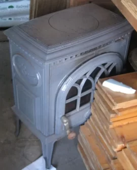

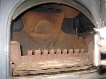

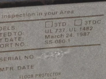

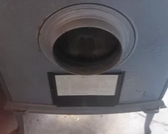

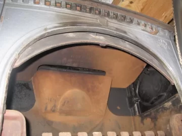

draft wheel shown here; this is from a stove given to me by a customer moving into assisted living. It fits a stove with two model numbers on the back plate: TD and 3TDC. No place in the stove for a cat to fit, it goes into the flue. I know the husband had a lot of creosote fires over the years, and that the stove was often damped down to try to burn through the night.

Condo-- Did you get this stove up and burning yet? I just picked up something very similar-- the same, actually, except the flue collar is much bigger, not enameled, and the rotating combustor is built right into it. Same plaque on the back with two serial numbers, same date, only difference is the configuration of the cat in the flue collar. Seems like they were experimenting. The combustor is 6", but then the collar expands to fit a 7" connector. Looks like yours is 6", though? Anyway, I haven't installed mine yet-- wondering if you've had a chance to fire yours up.
