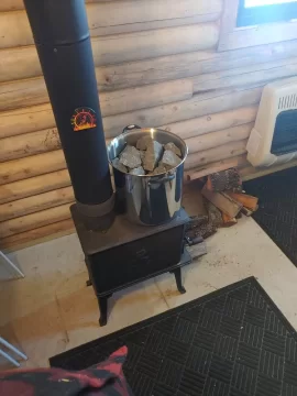

Hi...I am planning on using a Jotul 602 I have in a shed for a steam sauna. I am curious to what people have used on top of their 602 to hold the rocks. Would a large stockpot work? Would I need to put a piece of soapstone or steel plate between the stockpot and stove? Let me know your experiences you have had.

don't know i'm not a designer but a large pot sound like the right thing because if you hit the top of the stove when it is screaming hot with water you'll probably crack the top
Reactions: begreen
Cast iron dutch oven found at a yard sale. Fill with rocks, leave in place all the time. It will rust, but that just adds to the rustic charm.

I have a window in there to regulate the heat. It's actually a 8x14' bath house/sauna. I have a Nippa sauna stove in there now but the thing is a wood hog and sends most heat up the flue even with a pipe damper. We also take our showers and do laundry in there so it would be nice to have something more efficient and clean burning just to warm the place up for a few hours without going through a ton of wood. The smaller foot print of the 602 would give a little more room as well.

Works pretty slick, more efficient and only go through about a 1/3 of the wood compared to old Nippa. Of course it does take a little longer to take the sauna to come up to temp but that's fine.
