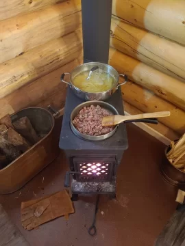

We cook all the time on the stove, mostly soups and chili but have also done Dutch oven recipes and it’s nice to warm up leftovers. We always have a kettle of water for coffee and tea that just stays on the back of the stove.

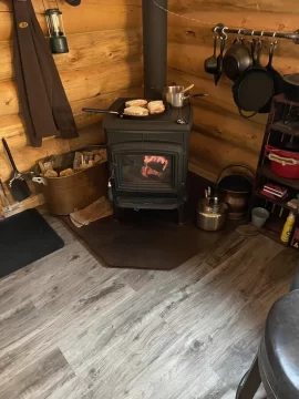

Grilled cheese and tomato soup

Oh, wow, looks great!
