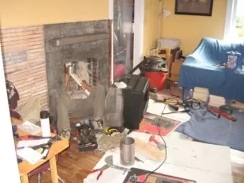

We now have it done.
We picked the C450 specifically because of how it can be mounted partially exposed into the room. We only have 600 sqft on main floor and 600 up for bedrooms/bath, so we couldn't go with a stove, too much room, but didn't want a fully recessed insert. That is also why we removed the brick facing of the old fireplace, to allow us to expose more top/sides of the insert without sticking it further into the room and losing floorspace.
There was a lot of work as the pics will show.
Stage 1 - Removed original mantle and brick facing that protruded into the room and was UGLY!
Stage 2 - Removed adjacent bookshelf and nasty plaster, cut back lathe to meet clearances, and removed old colored concrete hearth to cut out hardwood floor and extend hearth further. Thanks to my little guy and mom for their help getting the bookshelf and plaster off.
Stage 3 - Had textured concrete hearth and surround installed, as well as concrete mantle.
Note here - at this point I was really unhappy as I was certain the end result was going to look like a cardboard fireplace prop at the elementary school Christmas play. As the pics show, the colour is not done until it is finally sealed and cured. Even today, it looks better than it did the day it was finished, just because the concrete is now cured, as well as the sealer.
Stage 4 - install day -
Note here - read the manual over and over again, and measure things over and over again. I had a processional installer do the job, and all of is missed the 29" measurement on the Kennebec that allows the firebox sleeve lip to fit inside the fireplace, as we were all focused on the fireplace width at the back. In the end we had to cut 1/2" off each side of the sleeve lip to get it to fit back far enough to get the surround to meet the wall flush. I also missed the fact that we needed to insulate the liner to meet code requirements - still working on getting that fixed.

Sure you got enought clearance on all that old wooden strapping around the unit there Brent ?

Yes, it does suck to have to pay for the mistakes of others - you level of compassion is noted.... I am now well informed on the issue, and hope others can see thru thier situations to learn from my mistakes. Don't knoiw eveything - I am open to those with differing logical opinions who can express them respectfully.
Happy with the clearances - I had to pay close attention to the structural beam that runs in contact with the fireplace, and insulating the liner gives me a zero clearance requirement to combustibles in the chimney structure - that was my mitigation.
The strapping is cut back specifically to get it an inch away from the fireplace, so that I could have a code compliant fireplace before the install began, and it also kept what was behind the wall clear of the stove clearances - as required by my manual.
The only code compliance issue I have remaining is the fact that the Kennebec has really high hearth K/R value requirements - instead of simply stating that it needs to be on the hearth floor of a compliant fireplace, they spell it out - in the order of a K value of 2.82 if I recall - and I just couldn't get there given that I have a flush floor, so I went with a single pour concrete extension, from firebox all the way to hardwood with no joints or seams. There was no way for me to reasonably meet this requirement out to 18" in front of my door glass, and my installer didn't even know it was in the manual, and local code experts don't know a liner from stove pipe - but they are the authority having juisdiction, regardless of competency. I was able to meet it out to about 12", as thier are no combustibles beneath the fireplace structure there.

yeah that doesn't look to code at all, as a matter of a fact IMO an accident waiting to happen. Perhaps best to get a Fire Preventions Marshall to have a look at that.
Hate for you to burn down your house, then be flipping through a photo album later in life and seeing that picture of your kid giving the thumbs up.
FYI, in that second photo, would appear you have as much wood embedded as I do.
perhaps I can't tell clearly from any of your pics so I prolly shouldn't comment but I do not see any clearances to combustibles from the masonry work.

I will not argue with you, one way or the other - I note your sarcasm and a lack of genuine desire to add constructive input to my situation - rather, you seem to want to rub my nose in it. I suspect it is because you didn't like what input was passed on to you when you asked for some concerning your install.
Your angry and in my view inappropriate replies to me and others are recorded elsewhere on this site, for the rest of time as it should apply to the internet. I was not the only one who objected to your construction materials, but somehow I am the one you have zeroed in on.
We must agree to disagree, go and enjoy our stoves, and turn our efforts to constructivley helping those who ask for the input of the Hearth.com community. Regardless of what you do/say, that is what I will do, warmly and safely.
