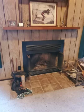

Can you post a picture or two of the fireplace? Do you have any of the fireplace before the C450 was installed? That would be helpful. If it's a heatform style then there may be a solution. If not, that could be a problem. I think they may have called it a ZC (zero-clearance) fireplace. In that case, this may not be a legal install. Many ZC fireplaces do not permit insert installation.

Before, this is the only picture I could find. I really appreciate the help.

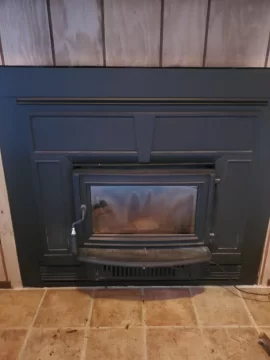

Begreen if you would like the videos of the rattle and movement I am able to email them no problem. Just having problems posting video to forum. I will post a photo of the insert when I get home tonight and can get a picture.
