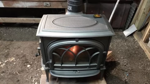

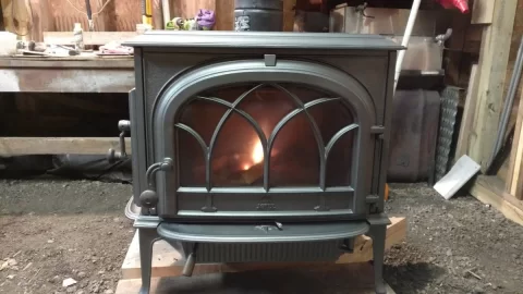

So this is the break in fire for the oslo after a long day cleaning painting gasketing. Oh how sweet the reward!

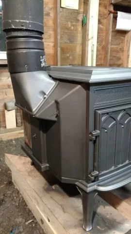

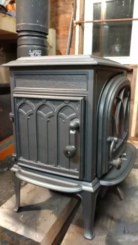

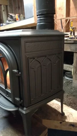

More views of the new paint job.

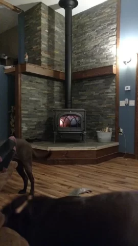

I just installed it on the hearth in the house last night but didn't get a chance to burn, had to help a friend track a deer...will post pics this evening. Still extremely impressed with how well this stove cleaned up and how beautiful it is. Hats off to stove bright paint.... now for the durability, not too concerned about that though. The rear and bottom heat Shields have also been installed. All in all about $1000-$1100 into the stove completely and maybe 10 hours of work with refinishing and installation. Looks and seems to preform as new even though it's a 2004 model. Hopefully a long lasting staple for our home. Thank you to everyone for the suggestions and tips and compliments.

Has been 4 years coming. Ahh the sweet blue flame! 80° inside 30° outside

Sharp looking setup. What type of burn times are you getting?
Reactions: goofa
Thank you very much. This is my first actual fire in the house so I'm not sure on burn times. The only burns I have done was the break in fire out in my sugar shack. Also this is my first EPA stove so it will definitely be a huge learning curve....

What pait is it that you used? The color is great. If and when I need to repaint Jotul, its gonna be that one.
Reactions: goofa
The paint was stove bright and the color is called "Jotul Iron." I used about 1 and 1/2 cans of the spray paint. Ordered online. Not sure if I'm allowed to "advertise" the website....if a moderator would chime in and let me know then I will post the website. It's rather hard to find, not sure if it goes by another name because it's not listed under stove brights colors.

Agreed. That color is legit....i like it. Do you have any previous experience painting or is it pretty easy for a newb?
We had a castine that was this color from the factory that we bought used and we sold it because we thought it was going to be too small and wanted to be able to use the side load feature on the Oslo...no regrets. We were stuck on the color and thought it wouldn't show dust and ash as bad as the matte black. My in-laws have the matte black and they love ours now and mentioned they may redo theirs.
As for the painting, I don't really have any experience to speak of. Although this summer I have done my fair share of spraying polyurethane with an hvlp. I kinda applied the same basic principles with the rattle can, smooth even light passes. Starting off the piece then moving across and ending beyond the piece. 3 light coats. Although I will say i was impressed at how uniform and easily it laid on. So long story short just take your time with the prep work clean well with a solvent and then spray even light coats. It's simple!!!
