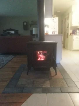

I owned a Jotul 600. It was primarily a side loading stove. I loved it except when front loading. Then it was messy. Our house was an 80 yr old 2000 sf craftsman with no insulation in the walls. It heated it nicely. Now we live in a 30 yr ofld ranch of 1200sf amd well insulated. I bought a Napoleon 1400 c and love it. Both stoves are great but the application was different. We needed close tolerances...front loading and less heat. This stove is steel with a cast iron jacket. The pipe comes right out the top and I can cool right on the steel because the lid goes up. I love it. But then...I loved the 600 too. Just had dif needs.
