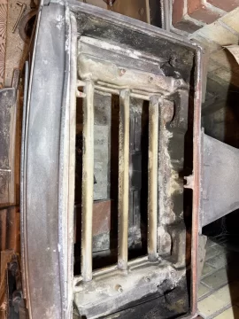

Removed the top plate and fire bricks tonight and I didn’t see anything obvious. Thought everything looked pretty good for a 25 year old stove. The only thing I did notice was a crack in what looks like some cement behind where the firebricks sit? Attaching some pictures here for reference.

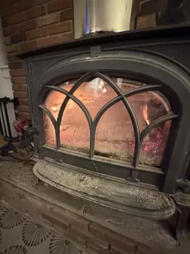

View attachment 342850This is a pic of the stove with the air control completely closed. Fire being fed from the left hand side.

That's just cement ooze. As long as it is still making a good seal in the cast iron joints it's fine.

Ash pan is full, and still the stove seems to be fed air from the back left of the firebox near the side door area and flames shooting down the left most firebrick. This is the stove with the air completely closed. Side door gasket is new and tight.

Check for leaks in that area starting with the dollar bill test on a cold stove around the full perimeter of the side door. Do a leak test with an incense stick or butt while burning to see if the smoke gets sucked in to any area or seam back there.
I would try removing that brick and all the ash around that seam then smear furnace cement in there.
